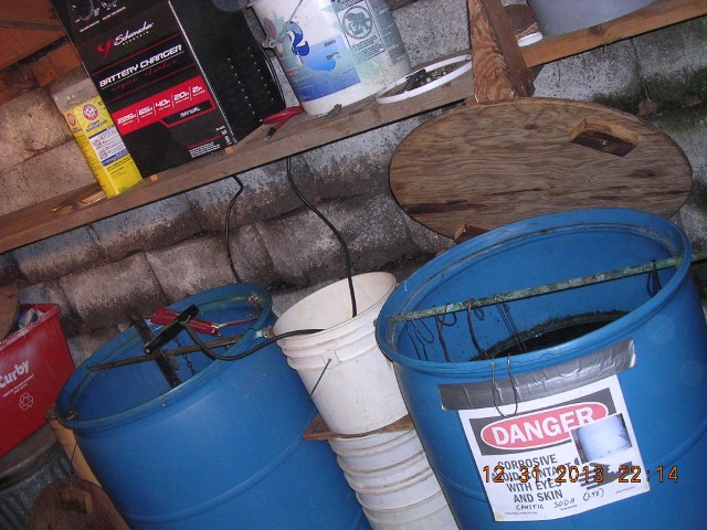

I have 2 blue 55 gal. plastic drums with the tops cut out. a 1/2" diam. steel rod through holes i cut close to the top. left drum is my Electrolysis Right drum is lye I use wire coat hangers to hang CI left side of drum you can see 4-5 of  hangers. It is all outside under a open end shed. have wood lids for both drums
STILL TYING TO LEARN TOO RESIZE PICTURES  :'(

« Reply #8 on: December 31, 2013, 07:10:23 PM »
The drums off craigslist  $5 ea
Sheet of stainless  for elcto found in
the freeway 10-12 years ago
 Battery charger Sams Club
the rest i had on hand

Keith - that is a very professional looking setup   [smiley=thumbsup.gif]
