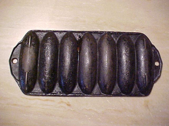

« on: February 15, 2003, 10:11:58 AM »
I've got a pic of a stick pan that I've never seen before and I'm confused about its origin.  If you let me know where to send the pic to post it, someone might be able to figure it out.
By the way, I'm new to collecting Griswold and my focus has become stick and gem pans.  I don't have many yet, but I'm really enjoying the hunt.
Thanks,
Jake :)

Jake, Looks like you have a Wagner corn stick pan and according to the info in the blue book it was made in the 40's. I would suggest buying the Blue and Red books on Griswold, Wagner, and others. They are a good, quick way of getting up the curve on a lot of cast iron. You can get them for Greg, the webmaster of this site.

THanks for the info, Harry.  I suspected it might be a Wagner.  I forgot to mention that the inside of the pan is the wheat pattern, not corn, which is why I was confused to not see "corn or wheat" on the back.  Any idea on relative value/rarity among other Wagner pans?  I'd like to know if this would be of interest to others who collect Wagner.  I'm sticking to Griswold pans for now.

I have argued at length with people about these pans.  They are NOT Wager.  No catalog number; no constant "letter" like Wagner marked their pans prior to using catalog numbers on the pan.   The pan does not show up in any Wagner catalog that I am aware of.  The pan HAS to be newer than the Griswold ones since Griswold had a patent on the design that was issued in 1927 (filed for in 1925).
Those stick pans appear with no letter on the back, with the letters B and E and possibly one other letter.  An earlier version with the same marking but no letter has just 6 sticks.  There is absolutely nothing about the pan that says Wagner and I'll argue that until someone PROVES to me that it is Wagner.
Goes to show, if you believe me, that what is printed in books is not always right.  But, once printed, it tends to become fact.  I am on a mission to set the record straight and to encourage people to use their eyes and minds to determine if what they read in print is the truth.  Authors do not give enough documentation, proof, or captions to validate what they say.
On the G&CICA Griswold History page it says "The closest I can get to the date they started making cookware is 1865".   The date was several years later a few weeks ago when I emailed the webmaster Kathy and asked her where she got the info.  She replied that it was a type and that it should have been 1865.
I was under the strong impression that Griswold started in 1865 but they made hardware items such as a separable butt hinge.  Cookware came much later and my guess it around 1880.  By 1883 at least Selden & Griswold had a full line of cookware from a little 1883 catalog sheet I have.  When did they ACTUALLY start making cookware?  I don't know but I bet it wasn't even close to 1865.  Yet that is the date written in infamy on the G&CICA site.   People who write things need to give a reference on where they found the information or history gets screwed up for all time.
I am always questioning things but am absolutely willing to listen to reason if other ideas come up.  The hard information on what we want to know in our hobby just isn't readily available and probably will never be available.  We have to guess and deduce a lot but, please, say it is a guess or estimate.

I agree with you Steve NOT Wagner. I don't know a Wagner collector that thinks that it is.  John

Jake, I guess I should have said "according to the Blue Book you have a Wagner pan". Steve S. sure knows a lot about this stuff and if he says it isn't so that's probably the case.

Well, this sure stirred up some interesting dialogue.  I suppose for now there is no consensus on the maker of this stick pan, but its resemblance to the Griswold 2700 is striking.  Could it have been a piece from the Puritan or another line of ware that was branded for someone else?

Shearylon:  That wheat stick pan is a regular production cookware item and was made in fairly large numbers judging by the number of them I have seen.  The Griswold Pup was a limited, non-cookware item GIVEN away by Griswold or, possibly, SOLD to jobbers to do with what they wanted.  I don't believe that it was a production item and, as such, would probably not be included in the G catalog.  I know what you are inferring.  That wheat stick pan is NOT Wagner.  Prove it to me that I am wrong.  Show me some reasonable arguments.  I am listening.
Jerry:  Those pans come with no letter, the letter B, the letter E and, I think someone pointed out to me, another letter.  Wagner used the letter B for their popover pans.  Wagner used the letter E for their cornstick pans.  Wagner lettered or cataloged numbered all their later gem type pans.  Wager did not use different letters for any of their identical pans.  That wheatstick pan comes in a 6-stick version which I presume to be earlier.  Again, due to the number of these pans I have had and seen they were produced in large numbers and probably over a several year or many year period.  As such it SEEMS that, if Wagner, they would appear in a Wagner catalog.  Maybe nobody has seen a Wagner catalog from the period that these pans were made.  I, personally, am highly convinced that they are not Wagner.  Give me ANY logical reason why they are other than the blue book shows the pan under the Wagner section.  The book  (see p. 263, top, right) does not say that the pan is Wagner, only that the B is characteristic of Wagner (but only for their popover pan) and the two holes in the handles are also characteristic.  Big, deal, any foundry would have put in no hole, or one hole, or two holes.  The number of holes is not a way to tell who made a pan.  That pan is NOT Wagner.
Jake:  That pan does resemble the Griswold 2700 pan.  If you compare it to the 2700 (have you ever done so in person?  I have), you will see that the detailing is different, the casting quality is different,  the handles are  similiar but not the same, the wheat patterns are not the same (detail-wise); but the Puritan
