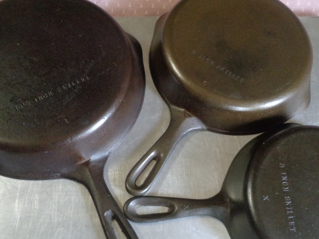

« Reply #5 on: October 15, 2023, 11:34:32 AM »
As you can see, they all have the newer style of handle that Wagner was using in the 50's.
From that I can safely guess that these pans are all about the same.
Correct?
  • Posts: 2117
Re: Unbranded Wagner skillets
« Reply #6 on: October 15, 2023, 02:55:55 PM »
These are post-1960 pans. More than likely pre-1970 before the purchase by GHC which ran their quality into the ground.
Someone who knows Wagner a little better than I might be able to say whether these are Palmer(sp?) or Tectronix(?) era pans.
As stated earlier, "Sure, you can find some of the ground cooking surface skillets during this time frame that are good users."

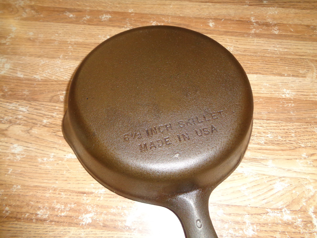

Shouldn't they have the "Made in USA" label like this POS?
