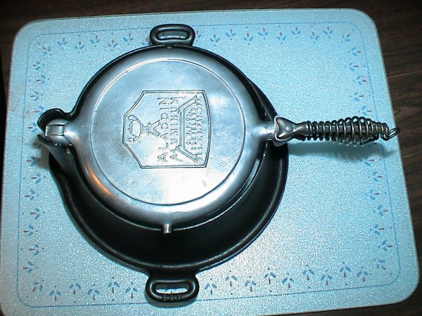

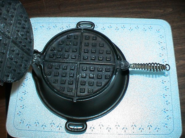

pix of aluminum cleaned with walnut shells
« on: January 24, 2005, 02:19:03 PM »
Thanks to Tom for the before and after pix.
Ken_j
Re: pix of aluminum cleaned with walnut shells
« Reply #1 on: January 24, 2005, 04:31:08 PM »
Looks good to me, very acceptable.
« Reply #2 on: January 24, 2005, 04:50:46 PM »
I agree this looks great.  I wonder if I can hook up my woodworking vac system to sandblast cabinent to get rid of the dust issue while cleaning?
« Reply #3 on: January 24, 2005, 05:46:58 PM »
WOW. :o   That looks nice from the "before" pictures.
« Reply #4 on: January 24, 2005, 06:05:38 PM »
Real nice job!!  Greg when you get your blasting cabinet set up it may make your  electrolysis set up obsolete. If you can get control of the dust. Seeing these pix makes me want to look into one.
